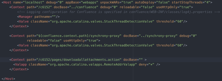

I try to install the workaround for CVE-2019-3398 (https://confluence.atlassian.com/doc/confluence-security-advisory-2019-04-17-968660855.html)
From now on, the server.xml file contain this line : <Context path="" docBase="../confluence" debug="0" reloadable="false" useHttpOnly="true">
The workaround (see above) contain "<Context path="/pages/downloadallattachments.action" docBase="" >"
If I use the line '<Context path="/pages/downloadallattachments.action" docBase="" >' to replace the actual line : it doesn't work.
Can you tell me how to adapt the workaround line considering (or not) the actual line ?

I've had a look at the workaround you mention, but I see that it doesn't mention to replace any lines, but to add it to the <Host> element.
You should already have some existing Context paths there, but don't modify those, just add the new lines inside of the <Host> element.
So mine looks like this:
Of course, if you are using a context path, you need to adjust it to your own, but the goal is to have it as another item in the <Host> element.
Can you give that a try and let me know how it goes?
