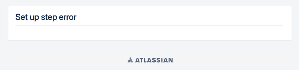

3) I did upload a backup file from previous conflunce server (backup-2019_03_11.zip) to <confluence-home>/restore directory, Build Index has been selected, next during one minute when I did try to found file in window below by clicking into No file ...lala-lala, I saw message with error. Take a look on a picture below:

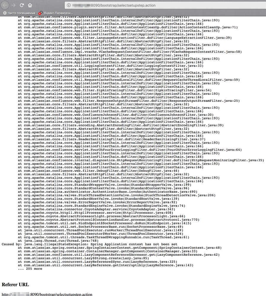

Then I did try restart service for my try to do it again. I had meet up with new error message in my web browser.

System Error
A system error has occurred — our apologies!
For immediate troubleshooting, consult our knowledge base for a solution.
If you would like to receive support from Atlassian's support team, ask your Confluence administrator to create a support issue on Atlassian's support system with the following information:
  1. a description of your problem and what you were doing at the time it occurred
  2. a copy of the error and system information found below
  3. a copy of the application logs (if possible).
Your Confluence administrator can use the support request form to create a support ticket which will include this information.
We will respond as promptly as possible.
Thank you!
Return to site homepage…
The SystemInformationService could not be retrieved from the container. Therefore very limited information is available in this error report.
The SystemInformationService could not be retrieved due to the following error: java.lang.IllegalStateException: Spring Application context has not been set
Cause
com.atlassian.util.concurrent.LazyReference$InitializationException: java.lang.IllegalStateException: Spring Application context has not been set
    at com.atlassian.util.concurrent.LazyReference.getInterruptibly(LazyReference.java:149)
caused by: java.lang.IllegalStateException: Spring Application context has not been set
    at com.atlassian.spring.container.SpringContainerContext.getComponent(SpringContainerContext.java:48)
Stack Trace:[hide]
	at com.atlassian.util.concurrent.LazyReference.get(LazyReference.java:112)
	at com.atlassian.confluence.setup.webwork.ConfluenceXWorkTransactionInterceptor.getTransactionManager(ConfluenceXWorkTransactionInterceptor.java:29)
	at com.atlassian.xwork.interceptors.XWorkTransactionInterceptor.intercept(XWorkTransactionInterceptor.java:56)
	at com.opensymphony.xwork.DefaultActionInvocation.invoke(DefaultActionInvocation.java:165)
	at com.atlassian.confluence.xwork.SetupIncompleteInterceptor.intercept(SetupIncompleteInterceptor.java:52)
	at com.atlassian.confluence.security.interceptors.SecurityHeadersInterceptor.intercept(SecurityHeadersInterceptor.java:39)
	at com.opensymphony.xwork.interceptor.AroundInterceptor.intercept(AroundInterceptor.java:35)
	at com.atlassian.confluence.setup.actions.SetupCheckInterceptor.intercept(SetupCheckInterceptor.java:27)
	at com.opensymphony.xwork.DefaultActionProxy.execute(DefaultActionProxy.java:115)
	at com.atlassian.confluence.servlet.ConfluenceServletDispatcher.serviceAction(ConfluenceServletDispatcher.java:56)
	at com.opensymphony.webwork.dispatcher.ServletDispatcher.service(ServletDispatcher.java:199)
	at javax.servlet.http.HttpServlet.service(HttpServlet.java:741)
	at org.apache.catalina.core.ApplicationFilterChain.internalDoFilter(ApplicationFilterChain.java:231)
	at org.apache.catalina.core.ApplicationFilterChain.doFilter(ApplicationFilterChain.java:166)
	at org.apache.tomcat.websocket.server.WsFilter.doFilter(WsFilter.java:53)
	at org.apache.catalina.core.ApplicationFilterChain.internalDoFilter(ApplicationFilterChain.java:193)
	at com.atlassian.confluence.web.filter.DebugFilter.doFilter(DebugFilter.java:46)
	at com.atlassian.core.filters.AbstractHttpFilter.doFilter(AbstractHttpFilter.java:32)
	at com.atlassian.plugin.servlet.filter.ServletFilterModuleContainerFilter.doFilter(ServletFilterModuleContainerFilter.java:51)
	at com.atlassian.plugin.servlet.filter.ServletFilterModuleContainerFilter.doFilter(ServletFilterModuleContainerFilter.java:45)
	at com.atlassian.johnson.plugin.servlet.filter.JohnsonServletFilterModuleContainerFilter.doFilter(JohnsonServletFilterModuleContainerFilter.java:50)
	at com.atlassian.confluence.util.message.MessagesDecoratorFilter.doFilter(MessagesDecoratorFilter.java:64)
	at com.opensymphony.sitemesh.webapp.SiteMeshFilter.doFilter(SiteMeshFilter.java:65)
	at com.atlassian.confluence.util.profiling.ProfilingSiteMeshFilter.doFilter(ProfilingSiteMeshFilter.java:50)
        HALF OF THIS LOG is deleted due restriction to this message in 20,000 characters.
Referer URL
http://local_IP_Address:8090/bootstrap/selectsetupstep.action
I did try to deploy Confluence on another fresh Centos 7 with external PostgreSQL 9.6.12 server.
When I did make copy backup file to restore directory, I saw the backup file in restore menu, that zip file, and I faced up with an issue:
The following error(s) occurred: Error unzipping file (This may be due to a large zip file): /var/atlassian/application-data/confluence/restore/backup-2019_03_11.zip (Permission denied)
After service restart, I had meet up same issue I told above, same case like in Debian.
