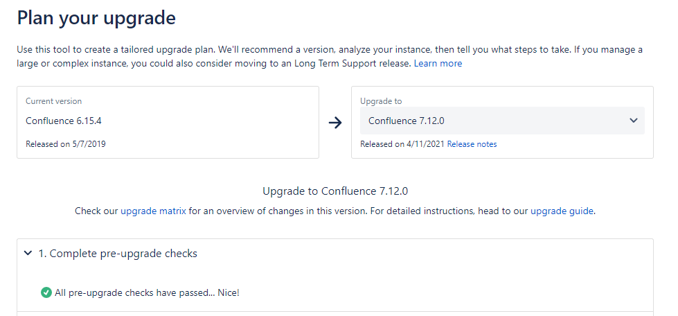

I am upgrading the confluence server from 6.15.4 to 7.12.0
Akshay Bhandakkar
July 20, 2021
Hi team,
When I click on the plan the upgrade in confluence it is showing me it is ok to upgrade the confluence to 7.12.0, Please let me know it is ok to perform a major upgrade. Please refer to the below screenshot.
current Postgres version: 11.10

I just went through an upgrade two weeks ago from v6.8.2 to v7.12.2 without issue. We also had to upgrade our RHEL OS, Postgres DB version and JDK version.
You are on Postgres version 11 so that is compatible. Check out further compatibility here:
https://confluence.atlassian.com/doc/supported-platforms-207488198.html
Just make sure any add-ons you have are also supported by the version you are upgrading to.
Nic Brough -Adaptavist-
July 20, 2021
Yes, that jump in versions is fine to do in one go.
