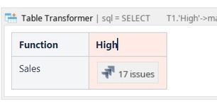

Hi,
Below is my table that prints the data as "17 issues" as a link. I'm trying to get this printed as only numbers. i.e.  just "17" while maintaining the same link address.
1) I tried REPLACE function and it printed "17" but the links were gone. Is there a workaround here?

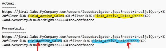

2) Then I was trying to use the FORMATWIKI function to retrieve the link info of "High" column, but the link info was incorrectly retrieved. Below is my code for table transformer.
SELECT T1.'High'->match("^[0-9]+") AS 'High', FORMATWIKI(T1.'High'->tfView->match("href=([^ >]*)")->1->slice(1, -1)) AS 'Link' FROM T1
