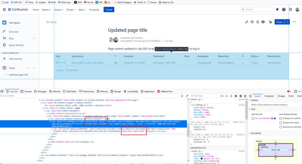

I created a new page, put some text on it, then added a Jira macro with a simple JQL lookup. I then inspected that page's HTML content to confirm the name of the macro:
So, I know the name of the macro is 'jira'.

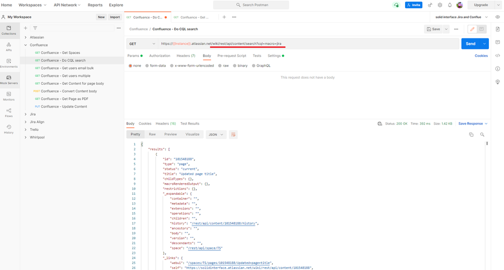

I then constructed a request in Postman to the REST API to do a CQL search to try and find any pages in any spaces that had a macro of that name in them:
Which worked just perfectly. The query found the correct page, told me the page ID, which space that page is in, and that page's title is a match for my test page.
In summary, the ability to use the REST API to do a CQL search to find macros by their names seems to work correctly for Confluence CLOUD. As to why it's not working for you for Confluence SERVER, I can't help any further; you will have to just be methodical and double check your code and method.
