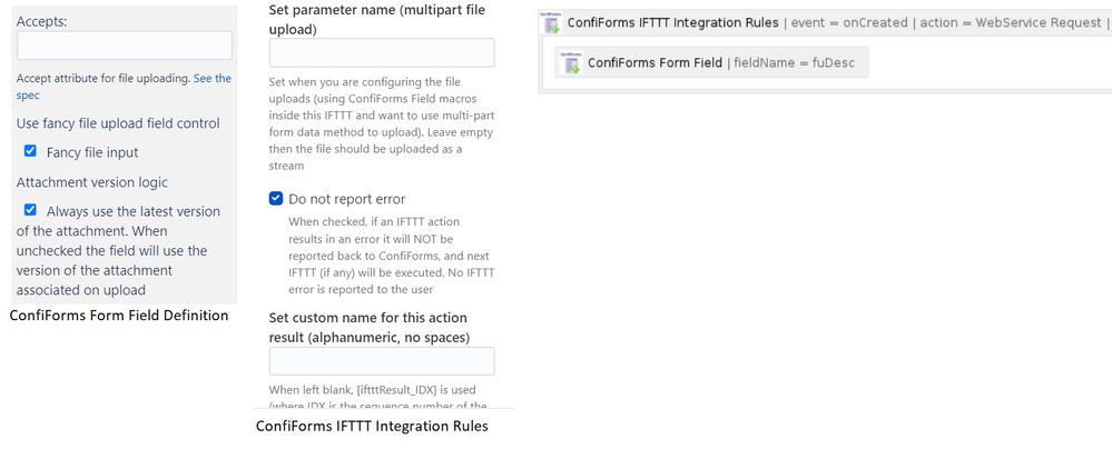

What content type do you set in the IFTTT that attempts to upload attachments?
Md Pervez Nawaz
March 24, 2022
I don't see any content type in the IFTTT. Attaching a screenshot related to the attachment.

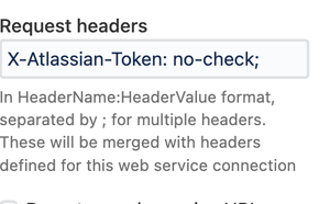

What do you have in the Request headers for the IFTTT that attempts to upload the file?
What is the HTTP method parameter?
Alex
Md Pervez Nawaz
March 25, 2022
@Alex Medved _ConfiForms_ The error was coming only when I am not attaching anything. If I am attaching a file, this error is not coming.
For request header - Earlier it was the same as the above screenshot: "X-Atlassian-Token: no-check;"
But I have removed it now, thinking this was causing the error. But nothing changed after removing this as well.
March 25, 2022
Was confused by your earlier comments, I thought you were still struggling to upload an attachment
So, you need to make the IFTTT conditional
Checking if the attachment is present, before attempting to upload it
!fuDesc:[empty]
Assuming the field is named "fuDesc" in your form
