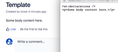

You have a very solid understanding of template and accessing the API for Confluence. I went through your example code and tested on Confluence Server 6.13. I did find a minor issue which may be causing your problem.
When creating the page, I found that your storage format was not closed properly. Here is what you storage value should look like:
"value": "<at:declarations /><p>Some body content here.</p>",

Please give your CURL call a try again with the value correction and let us know the results. I did confirm on my end it created a page with content (as seen from the screenshot above).

Unfortunately, closing the paragraph tag did not change the result on my end.  I suspect this problem is due to an issue with the version of Confluence I am using (not 6.13), and that you would have not seen string literals on your server even if you had not closed this tag
I have been able to find a workaround by first creating a template and then updating it with the storage format data I want.  I certainly don't like, but it works.
