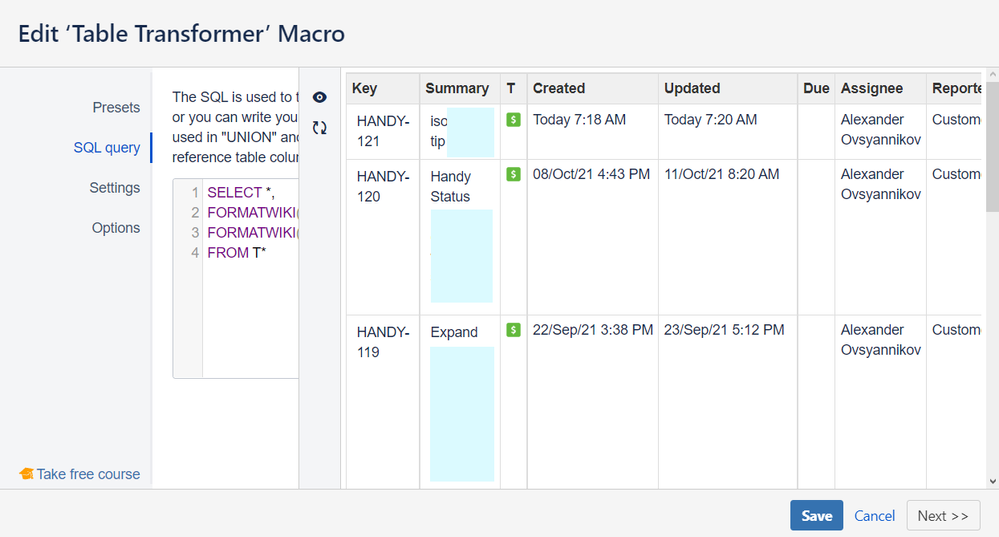

The add-on provides the Table Transformer macro that is often used for table calculations, conditional formatting and cells' adjustment. The latter could be a workaround for your case: wrap the Jira Issues macro into the Table Transformer macro.

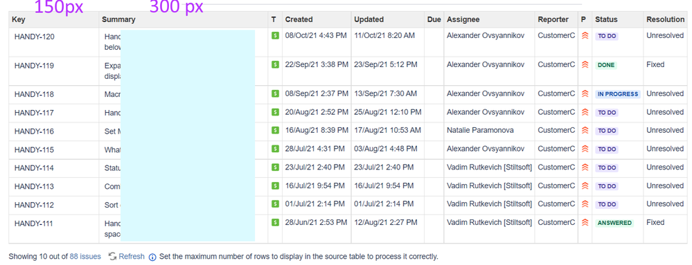

Then set the required width for the columns with links ("Key" and "Summary"):

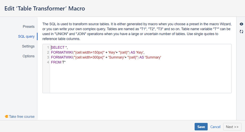

Wed 6-2.pngSELECT *,
FORMATWIKI("{cell:width=150px}" + 'Key'+ "{cell}") AS 'Key',
FORMATWIKI("{cell:width=300px}" + 'Summary'+ "{cell}") AS 'Summary'
FROM T*
Wed 6-3.pngThe FORMATWIKI function transformed our links into plain text and the custom column width allows you to make the table easy to read (for example, if we have long summaries).

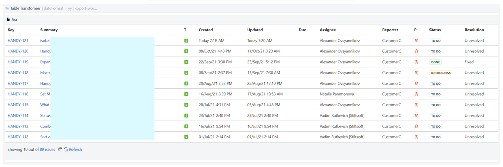

Here is the screenshot of how the Jira Issues table looks when the page is published:
