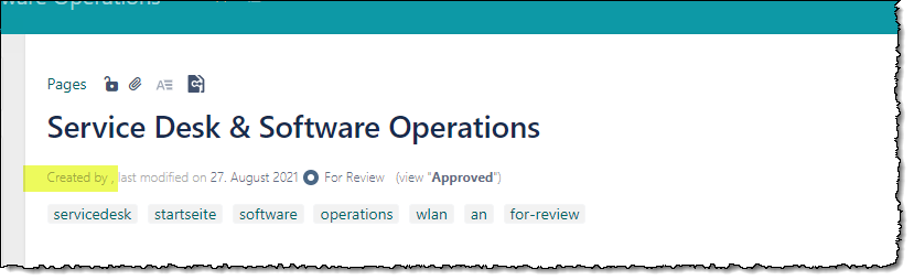

The following code added to the Stylesheet removes the author's name, but leaves the text snippet "Created by ," which looks odd.
Q. How do you remove that snippet as well?

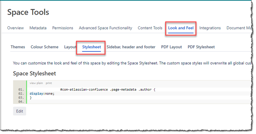

I can't find Stylesheet under "Settings > Look and Feel". Where can I add my custom CSS?
Thanks
Dirk Lindner
October 18, 2023
18-10-2023_14-09-46.pngThis seems to be possible only for the Confluence admins, not the Space Admin.

I have the same problem, I think the issue is that if you add the code to the StyleSheet, your page still displays the phrase 'Created by'.
In other words, you end up with something like:
"Created by , last modified on Feb 05, 2018"
The code insert removes the name, not the Created by phrase.
Ideally, what's left would be "Created on DATE" or "Modified on DATE".
Any thoughts on that?
