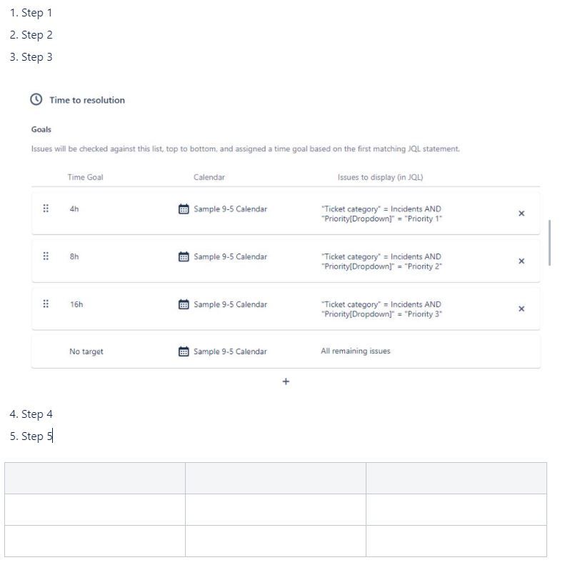

Hello @Donia
In order to keep the numbering of the list, you need to press 'SHIFT + ENTER'; this will add a new line below a number where you can enter additional text/ note or image. But this will not allow you to add a table. Table would be added at the end of the list.
Please refer to the screenshot, capturing this use case.
Also, there is an open issue with Atlassian for this use case - CONFCLOUD-7794

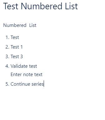

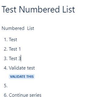

Hello @Donia
It does work for me and I tried it again with success.
In the numbered list, when you reach the point where you need to add the Note, pres 'Shift+Enter', and it will insert a line without the number. You can either add the note at this time or simply hit 'Enter', which would continue the numbered list and you can come back to this blank line later to add the text for the note.
Please refer to the below screenshot.
Kindly let me know if this helps or if you have any follow up questions.
