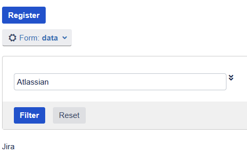

That's the page content after filtering i want to export to PDF (show result of 'Jira' only!):

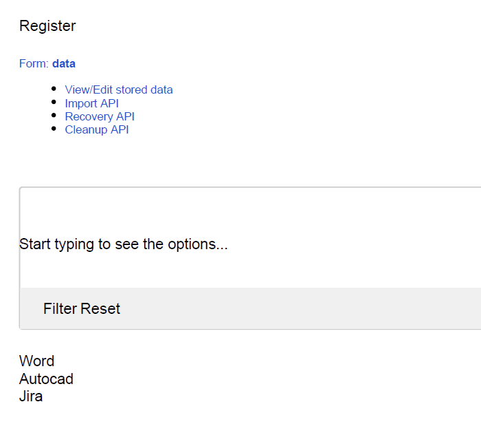

But unfortunately i get a PDF file after export showing all the form data in field 2:

ConfiForms (when using ConfiForms Dynamic Filter macro) dynamically filters the contents of a page. Confluence export functionality knows nothing about it and uses page storage format to render and generate the output PDF
The best option here is to use printing functionality of your browser and use "print to pdf" to print/export exactly what you see on the screen
