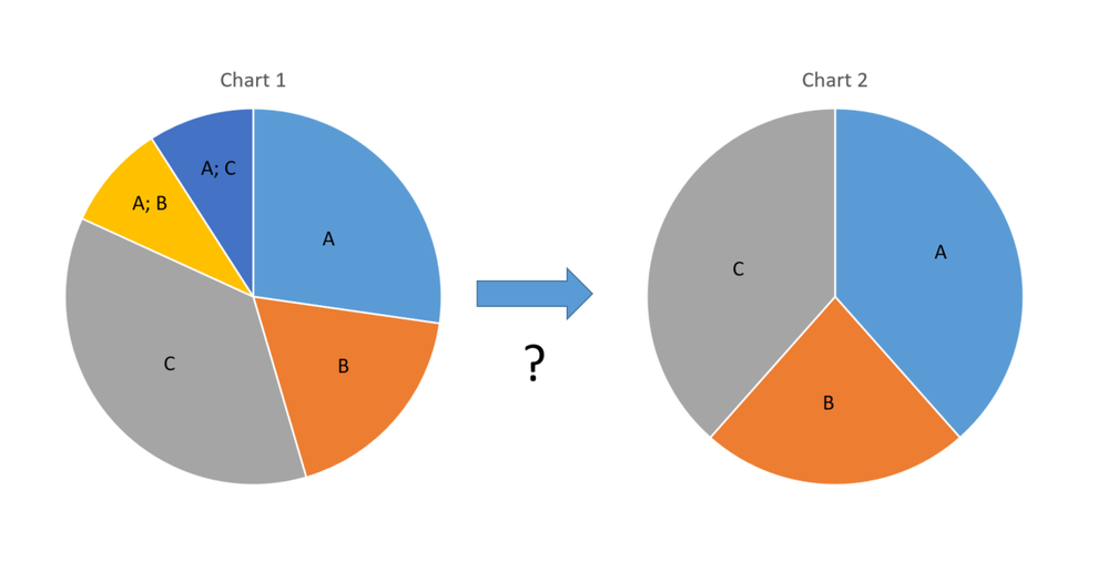

I have a checkbox group within a form that allows users to select one or more options. The form is then automatically plotted in a pie chart. When a user selects multiple checkboxes, confluence plots the entry as a new data point (chart 1 below). I would like the chart to count only the boxes checked (chart 2 below).
For example, if a user selects A and B from the checkbox group, I would like 1 count for A and 1 count for B, instead of 1 count for A; B. chart.PNG

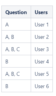

@Justin_Artis , we assume that you have smth like that:

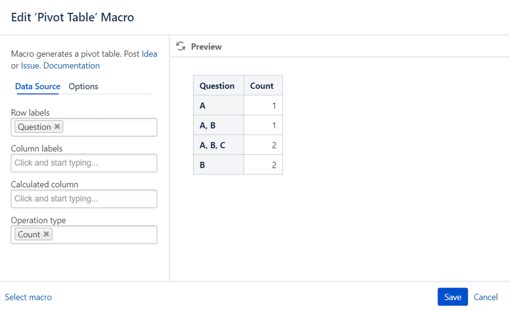

When you use the Pivot from Table macro with standard settings you count the number of variants (combinations):

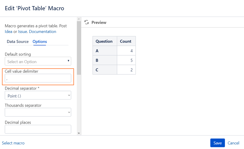

Pivot 1.pngBut if you go to the Options tab and set the Cell value delimiter, you will count letters:
Pivot 2.pngNow you can build your chart - it will look as the Chart 2 from your example.

Yes! That worked perfectly, thanks for your help.
