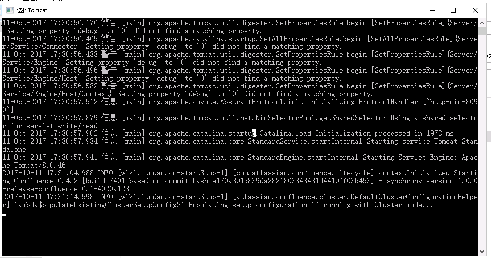

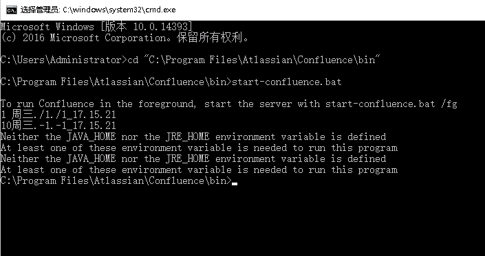

I have done as the link to migrate, install the windows confluence installer, copy confluence home folder to the new server, copy the server.xml, copy the mysql jar. And then startup the service, and run start-confluence.bat, the error in the following screen shows up. I set the jre path in the setclasspath.bat set JRE_HOME=C:\Program Files\Atlassian\Confluence\jre, and then run again, it shows up as the second screen. And I try to open confluence in the IE with localhost:8090, it can't open. What can I do ?screen1.png

What you see in the application logs ? Can you provide the application logs here ?
Which version of mysql you are using ?

Thanks, this issue has been figured out, the reason is that the new server can't reach the mysql server.

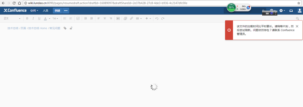

but we found the other issue, with the latest installer, I can't edit the confluence document, it will show up the error as below:can not edit the document.png

If I'm translating that correctly, it means it can't get a connection to Synchrony.
To test this theory, try going to Admin -> collaborative editing, and turning it off.  Can you create/edit a page with that turned off?

Yes, after I turned off collaborative editing, the doc can be edited and saved. Btw the error words in the screen shot are "It is loading slowly, please get help from administrator". And Just after I log in the confluence, there will be a warning message: The collation health check has failed. Maybe there does have one error for collation? how can we fix it?

I am sorry, I did not explain this in detail because I have seen it a lot, and forget that other people have not.
There are many problems that might give you that error message.  The test I asked you to do on collaborative editing rules out a lot of possible problems, and in a good way - if you'd still not been able to edit, we would be in a worse place.
You should fix the collation error, just in case your users try to write pages with content that won't save properly, but it is not the cause of the problem with collaborative editing.
The issue you have with editing is because Confluence cannot talk to the Synchrony service.  Synchrony is installed alongside Confluence, not as part of it, so it looks a bit odd when it doesn't work.  Could you have a look at the Confluence and Synchrony logs generated at a time that you tried to edit and failed?
