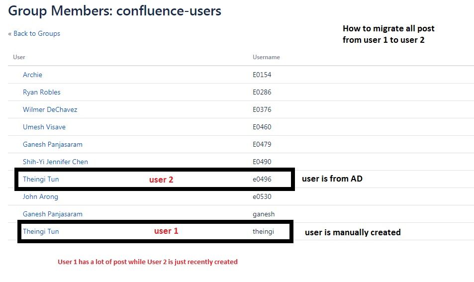

confluence.jpgHi Support,
Please help us migrate all current post from user 1 to user 2.
We need to remove the user that is manually created and replace with Active Directory users.
The problem is User 1 has a lot of post already and we need to limit the number of users.
See attached file for more details.

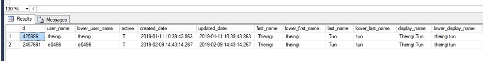

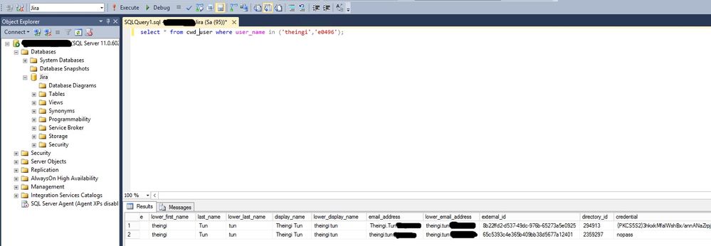

I have additional problem as both users are not on the same directory.
Please see attached file for more details.

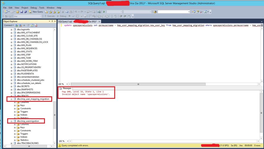

I have problem on step 11.
https://confluence.atlassian.com/confkb/how-to-transfer-content-ownership-in-between-users-958450595.html
update spacepermissions set permusername = tmp_user_mapping_migration.new_user_key from tmp_user_mapping_migration where spacepermissions.permusername = tmp_user_mapping_migration.old_user_key;
Thanks,
John

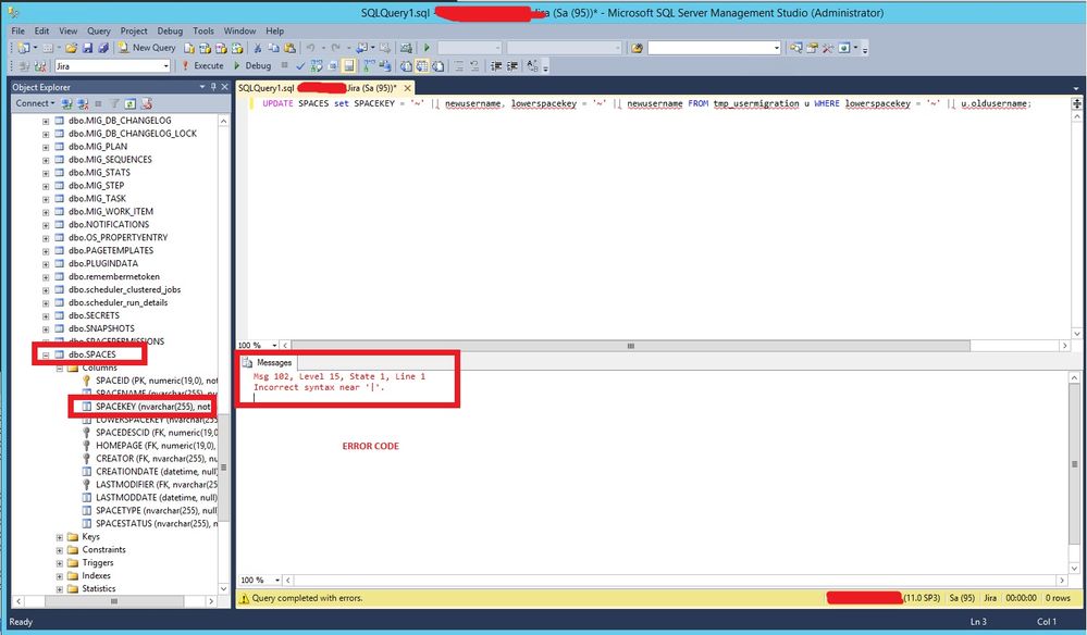

I encountered another error.
Thanks,
John
Kgi IT
February 13, 2019
UPDATE SPACES set SPACEKEY = '~'+ newusername, LOWERSPACEKEY = '~' + newusername FROM tmp_usermigration u WHERE LOWERSPACEKEY = '~' + u.oldusername;
Alexey Matveev
February 13, 2019
I guess, something wrong with the syntaxis. I am not mush into MS SQL Server and I do not have it installed to check it.
Please update the documentation and set the character in upper case for tables name and column name.
second issue is;
change the || sign to + means to concatenate.
