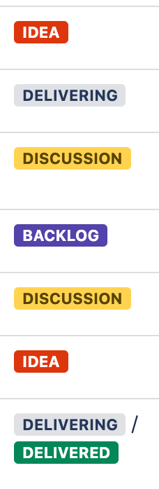

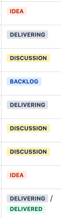

The colours used in the Table Filter and Charts macro do not seem to match the colours used by default in statuses. This is then very confusing in tables.
Some of the colours have slightly different tones, but the key issue is that these conversions have been made:
  • Purple -> grey
  • Blue -> purple
As grey also goes to grey, either purple or grey is essentially blocked as an unambiguous colour.
Is this a know issue?

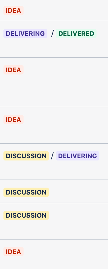

Thanks for working on this, the theme is much better, but the purple one still doesn't match. In my example about, I have "DELIVERING" as the purple colour, but in the table below it is still shown as grey.
Andrey Khaneev _StiltSoft_
August 21, 2020
Hi Samson,
Yes, we are aware of the issue with the purple status. The reason for the issue is that Confluence returns purple status as grey when the Table Filter macro gets its body so it is impossible to distinguish those two statuses. The same issue you can see if you export the page to PDF with those two statuses.
