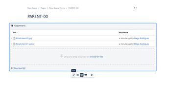

- Create a new page
- Insert the Attachments Macro

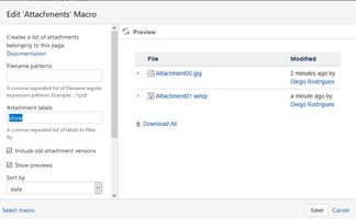

- Go into the macro settings
- Scroll the fields in the left side until you can see “Attachment labels”
- There, we will need to define all the labels that can be shown
- Save the settings
- Publish page

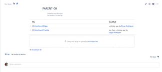

- Go back to the page view
- Check that your attachments are now displaying
The objective of hiding specific attachments can be achieved. However, instead of defining which labels can not be shown, we select those that can be shown.
