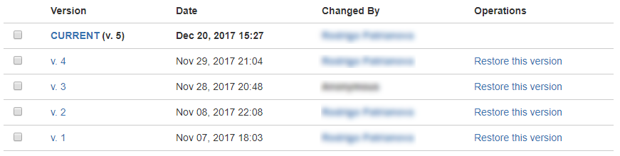

Is it possible to get all content versions using REST API? Today we have a Confluence page with the below versions:
I would like to know whether I can get the above data using REST API. Currently we are using Confluence 5.9.10.

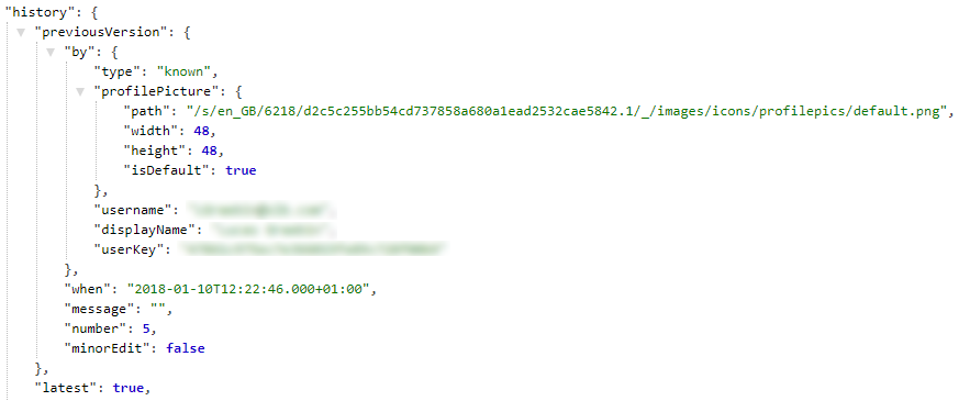

It's still not working. Please check below the previousVersion node of the content.
IMG_11012018_083805_0.pngI'm getting a 501 when I call https://<HOST>/rest/api/content/104021180?expand=version,history.previousVersion&version=4 and https://<HOST>/rest/api/content/104021180?expand=version,history.nextVersion&version=1.

Stephen Deutsch
January 11, 2018
Hi Lucas,
I apologize, even though it is there in the documentation and the REST API browser, the version parameter does not appear to be implemented (that's what the 501 refers to), so that's why it doesn't work, not that the pageID changes between versions (the pageID does stay the same for earlier versions).
It seems then that the only options are this https://<host>/rest/experimental/content/<pageId>/version call or https://kb.zanox.com/rpc/json-rpc/confluenceservice-v2/getPageHistory, but the second one has to be called with a POST request, so it's not possible to do it directly from the URL bar in the browser.
