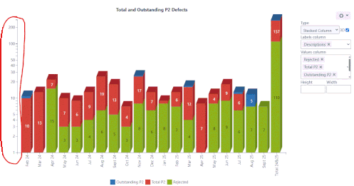

ASK / Question? = How to display the Y axis numbers in percentile %

sharing the screenshots of current table chart with numbers on the Y axis
ConfluenceSpace_MonthlyDefects_Create_a_chart_from_data_series_Display_Veritical_PASS_Yaxis_NumbersOnly_.gif
ASK =display the Y axis numbers in percentile %

Hi @Biju.Shankar ,
We suppose that you are talking about this question: https://community.atlassian.com/forums/Confluence-questions/Cutomized-X-Y-Bar-Chart-for-Confluence-or-JIRA/qaq-p/3123394
If you don't have the Table Toolbox macro, it means that your tags are wrong and you are on Data Center (not on Cloud).
On Data Center you can nest macros directly on the page - you don't need other tools to do it (the Table Toolbox macro was designed specifically for Cloud).
So, just wrap your source table in the Table Transformer macro and then in the Chart from Table macro. Other settings from @Katerina Rudkovskaya [Stiltsoft] 's answer (SQL query, Chart's settings) will be the same - you just need to replicate them.
