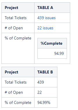

Hi,
I have one big table that I want to display counts of:
  • Total Number of Rows
  • Count of records with status "OPEN"
  • Calculate Percentage of Done
I was able to populate Table A with three macros (see screenshot). But this solution is heavy and takes a long time to load as I have many other macros on the page.
Any lightweight solution to look like Table B? Please note, I do not have TRANSWIKI.

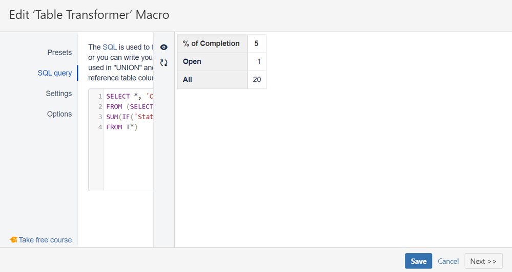

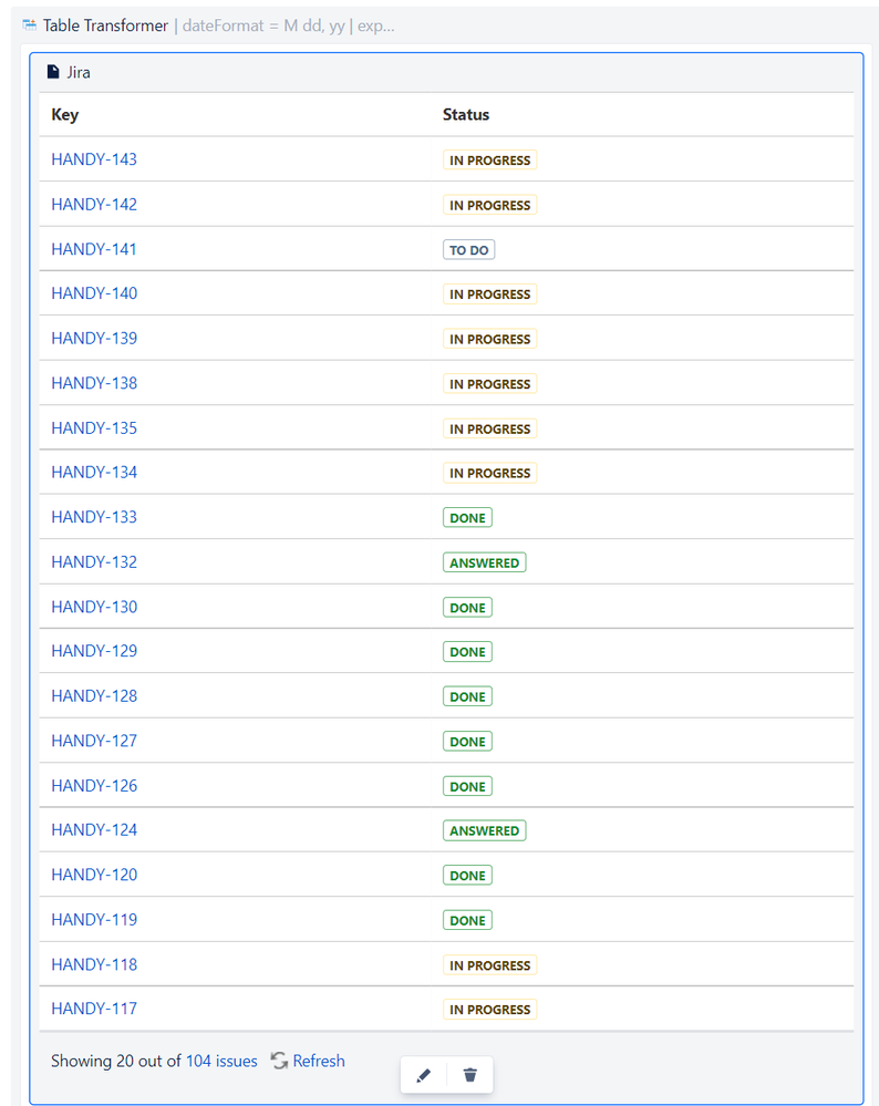

Hi @Leona ,
As @Srinatha Tondihal has kindly mentioned, the similar case can be achieved with one Jira Issues macro and one Table Transformer macro.
SELECT *, 'Open'/'All'*100 AS '% of Completion'
FROM (SELECT SUM(IF(T1.'Status' = "To Do", 1, 0)) AS 'Open',
SUM(IF('Status' IN ("To Do", "In Progress", "Done", "Answered"), 1, 0)) AS 'All'
FROM T*)
To get a vertical table instead of the horizontal one go to the "Settings" tab of the Table Transformer macro and check the "Transpose result table" option.
Hope this helps your case.
