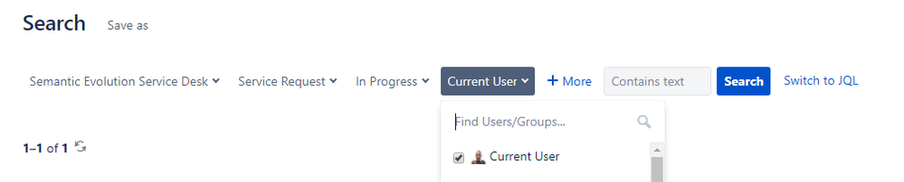

The above two solutions definitely work, but I have another way you can do this and it will help you learn JQL quickly.
  1. In Jira, click on the Search icon in the left toolbar.
  2. Select Filters at the bottom.
  3. Click Create Filter button (top right).
  4. Select your Project, Type, Status, Assignee and any other criteria through the +More pull down.
  5. Click the Search button. See results.
  6. Now click Switch to JQL and you can see the script.
  7. Switch back to Basic if you want to change stuff, or try out the script yourself (it is actually very easy once you use it).
  8. Save the filter - Give it a name and note the ?filter=xxxxx number.
  9. An extra step in the save could be to Share the filter with your colleagues or a group.
  10. In Confluence add the ?filter=xxxxx number to your Jira Macro and voila you have your results.
Filter - Basic View:
Filter - JQL View:
