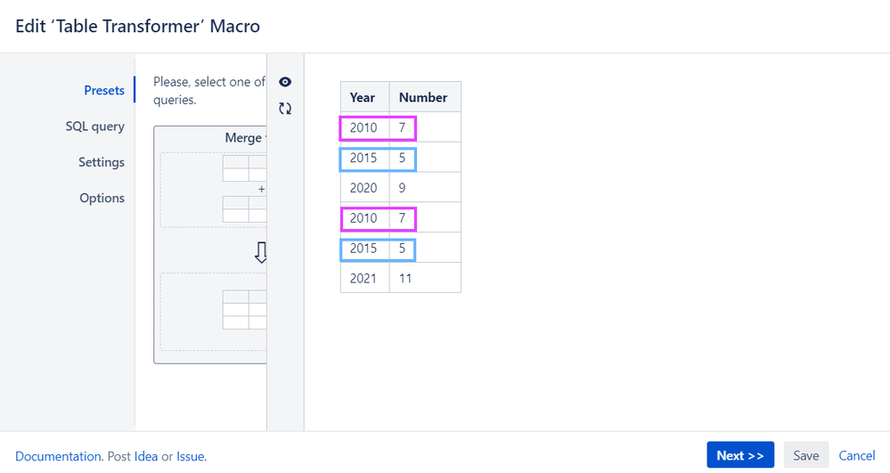

If your tables are based on the Jira Issues macros, then you may use the Table Transformer macro to combine them with the help of the Merge preset (as, I suppose, your are doing now).

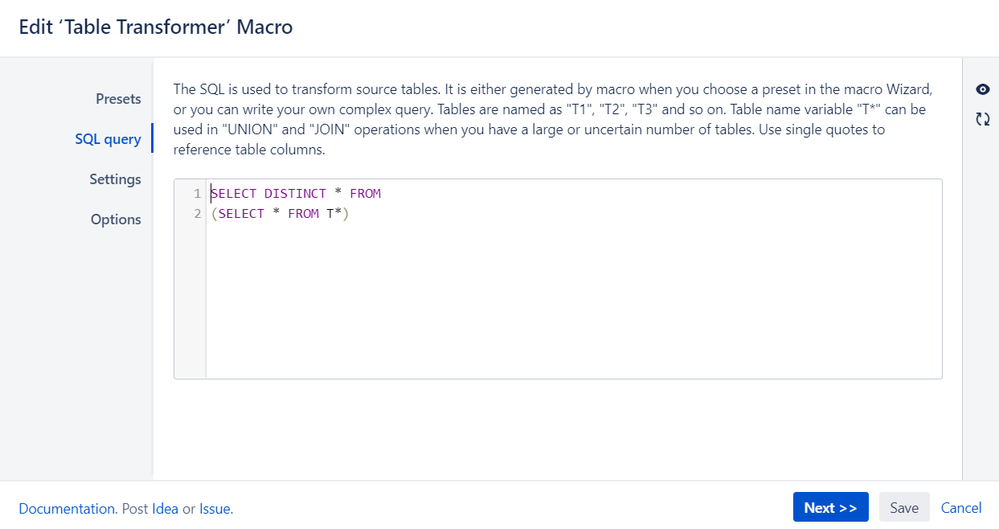

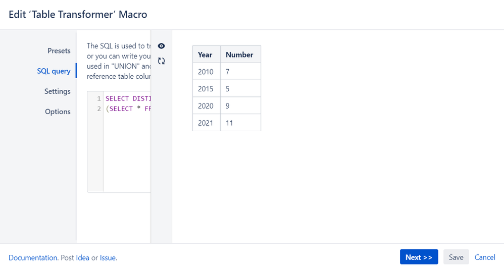

The easiest way to get rid of the duplicate rows is to go to the Custom transformation and use the following SQL query:
SELECT DISTINCT * FROM
(SELECT * FROM T*)
Hope this may help your case.

I've changed the original answer (not sure what version you have seen), so you may try the option with one Table Transformer and the following SQL query:
(SELECT * FROM T*)
