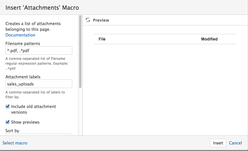

Thank you for your reply and apologies for not being exact in my previous response. I should have written "nothing happens", i.e. I get an empty page.
I've defined all the types of files I need to publish, in both ways (i.e. *.pdf and .*pdf, etc). For brevity purpose I've labeled them all "sales_uploads", which is the label I've inserted in the macro.The result is a blank, empty page, hence my question about the permissions. (see attached screenshot, after having clicked on the "refresh" icon)
Note: all the files were uploaded by me, through my own user session, so in theory I should be able to index and find them (I hope that my colleagues will be able to see them as well, but we'll leave that problem for later)

The Attachment macro only displays attachments of the page it is embedded in by default. Just to make sure: Did you select the repository page containing the files in the options further down? Try listing the attachments without setting any options apart from selecting the repository page.

"...attachments of the page it is embedded in by default..." That seems to be the problem - i.e. that whatever is uploaded *must* be associated to a page from the very beginning, an approach which from my previous experiences is somewhat restricting. To answer your question: yes at the very beginning I had tried to leave everything blank, but it still didn't work.
As an option I've begun to test the "Space Attachments" macro:
  • Pro: I've noticed that it does display the list of all uploaded files (good - for a repository)
  • Contra: it appears that the option of calling only the files that are associated to a given label doesn't work, i.e. all files associated to the space are always displayed whether they are labeled or not, and irrespective of the specific label filter.
Given the nature of these problems I still believe there must be some kind of permissions issue at the heart of the matter and is not a system bug or malfunction.
