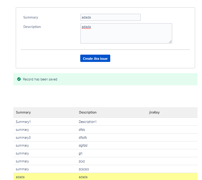

Thanks for your early response... my issue is whenever i submit a form in confluence page, it should populate an issue in Jira but on submission it is not creating any issue in jira. It shows the data which is updated through form. Even it is not creating the jirakey/Id. Moreover we are not getting any errors after submitting the form.  In ConfiForms IFTTT integration rules, i selected the action item as "Create a Jira issue" and server as "Jira-server", etc. But it is not working....

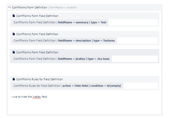

For your reference, Im attaching the screenshots of my form...form3.pngform2.pngform1.png

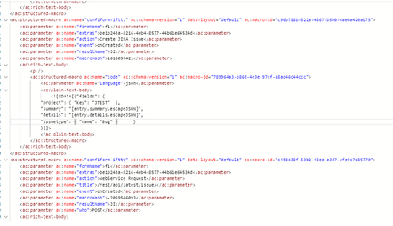

Please put JSON mapping you have into the "code" macro (wrap it into the code macro)
Also, when using new Confluence editor please set the form name parameter for ConfiForms IFTTT macro to link it to the form

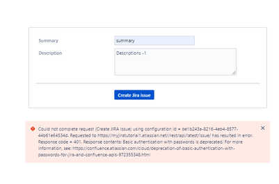

Thank you for your response...As suggested by you , we applied above steps in our form. Now when we are submitting the form, we are getting the connection issue. Already we have created a jira server using API tokens. Below is the error code wee are getting..
"Could not complete request (Create JIRA Issue) using configuration
id = be1b243a-8216-4eb4-8577-44b61e64534d."
For your reference, Im sharing the screenshot and code..

Alex Medved _ConfiForms_
August 27, 2020
I cannot tell more than the error message you see - you cannot use basic auth with Jira cloud as it says and should use Atlassian access tokens
See the URL mentioned in the error message and generate an access token to Atlassian Jira
(https://confluence.atlassian.com/cloud/api-tokens-938839638.html)
