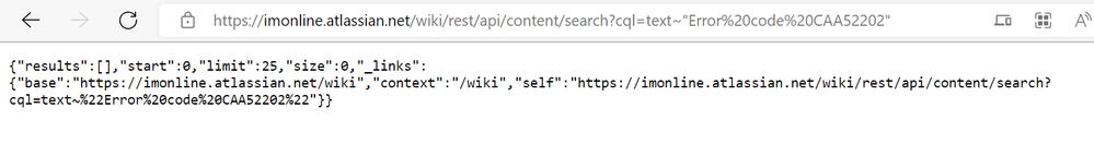

Yes, my text string is this:
search?cql=text~"Error%20code%20CAA52202"

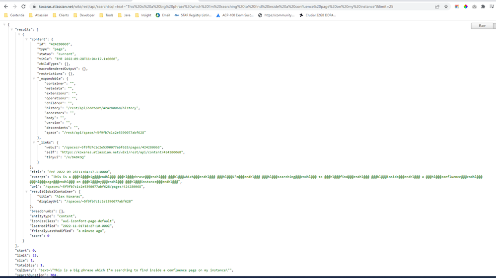

I've searched for a phrase with 88 characters:
This is a big phrase which I’m searching to find inside a confluence page on my instance
And I got results:
So I find no issue with the specific problem you are referring to. The above http request has a limitation of 25 results per page, not characters.

@Dong, Kevin can you post you whole http request, as well as the response you are getting? Because you shouldn't have a problem using long CQL text strings.
And if you search from the search field inside confluence, are you getting any results? If yes, where this text is located? On the body or page title, or somewhere else?
