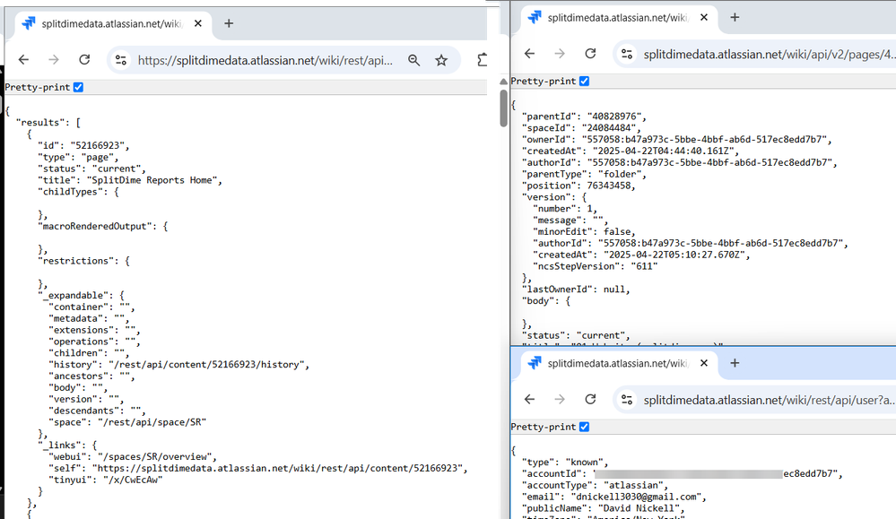

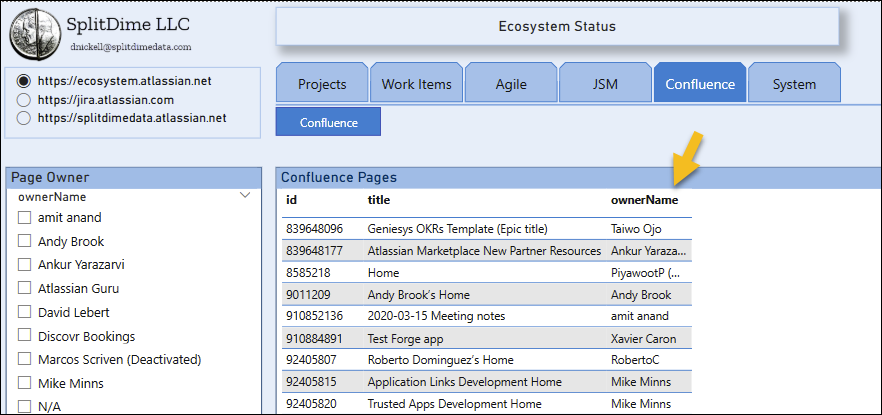

Many of my anwers in this forum are REST API Based and this one is no exception.   So here is how I can get the Page Detail (including OwnerId and Display name)
btw - great question... I was about to give you the creator and not the owner  :-)
Step 1 - Get all the Pages (I used url:/wiki/rest/api/content/search?cql=type=page)
Step 2 - Page detail (I used url:/wiki/api/v2/pages/41746435)
Step 3 - take the Owner Id from step 2 and get the display name (url:/wiki/rest/api/user?accountId=557058:b47a973c.....)
Run manually through a browser, it would look like this:
