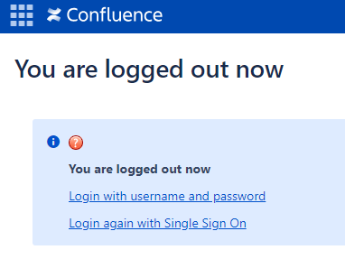

If you have a working SSO account, you can log out and get login page with username and password:
Usually this requires that the system is configured to allow bypassing SSO authentication.
  • Try following linksURLs <BASE_URL>/login.action?auth_fallback or <BASE_URL>/login.action?nosso
