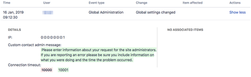

Building a monitoring system to review and record the audit logs sounds like an awesome idea. With this said, the relationship between the API JSON response and the UI and not a perfect match but they're very close, I will present an example which compares the UI to the JSON results:
For this example, I made a change within the Global settings changing the Connection Timeout from 1000 to 10001. The UI will report results as follows:
The JSON response will be seen as:

This should help to paint a picture of how the UI is matched to the JSON results from the API. The API will report much more detail than the UI has which will make a monitoring solution which uses the API much for viable.
You may find more about the audit records within the API at: GET /rest/api/audit. Along with the Confluence documentation for Audit Log.
