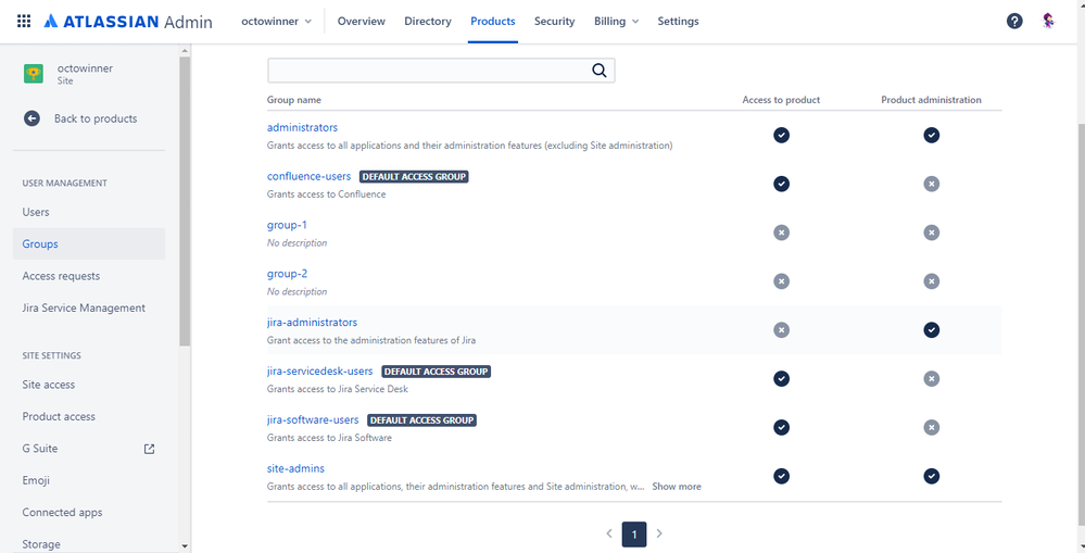

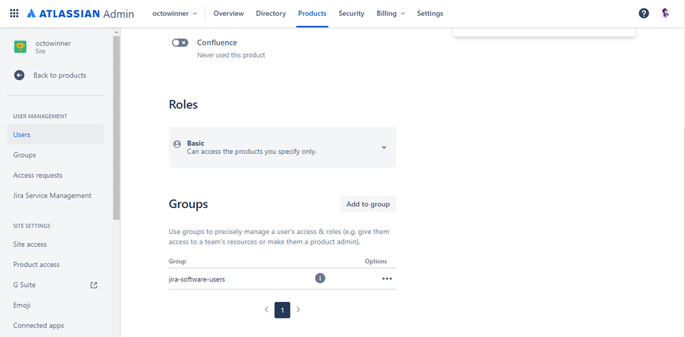

Pramodh M
February 5, 2021
Check under these groups once
Under Each User check the group they are in
Thanks,
Pramodh
Pramodh M
February 5, 2021
FYI,
They should not be under administrators, site-admins.
