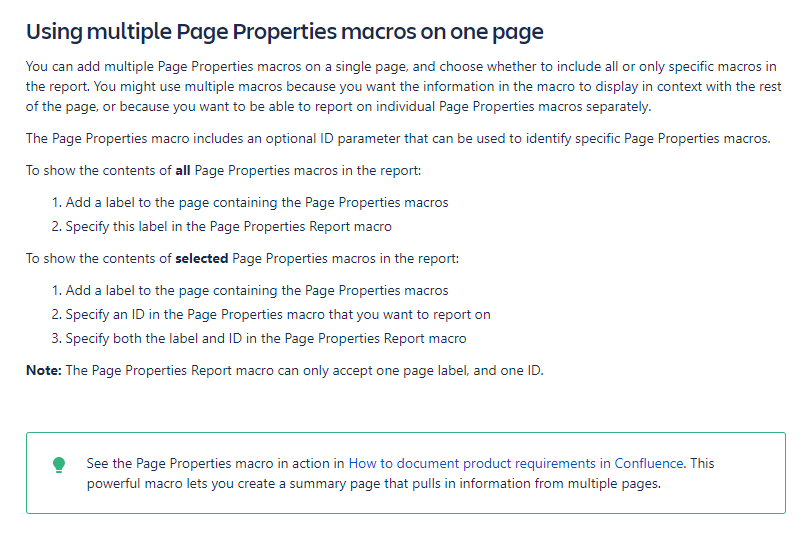

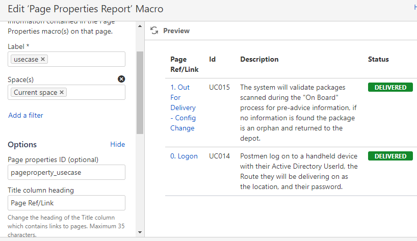

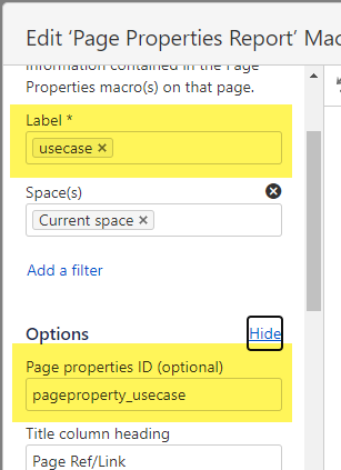

I have followed this documentation but still only get the first page property macro data in the my Page Properties Report on another page.

It took me some fooling around, but I think I found out what the problem is. The page property report shows a list of pages with the unique properties of that page next to it.
Each property you add to a page must be unique. You can split the page properties of a page across multiple page properties macros, but still they need to have different property names. The properties in your page properties macros are identical, so that won't work.
If I'm not clear, you can test what I mean by changing the property names in your second table to ID1, Name1, Description1, Actor(s)1 and Status1, removing the pageproperty_usecase id from all macros (page properties and the reports). The columns of the second table then should be listed in the report on the same line as the columns of the first table.
For the result you're after, you'll probably be better off by creating separate pages for Logon Postman and Logon Ops Controller, or maybe adding a property to your table where you list the various logon options the UC applies to.
