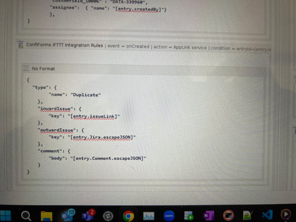

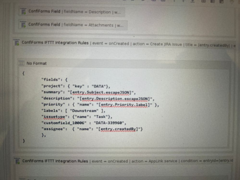

As you can see in the First Image, I am using the Action - Create JIRA Issue - so the JIRA ID which gets created here, needs to be passed to the second image, which uses “AppLink Service” Action to Link this JIRA which is created to an existing JIRA ID, but I am facing an issue to pass the JIRA ID which got created in the first Macro to the next Macro
You need an extra IFTTT in-between, as explained in my comment - to save back the issue key
PS, the condition for the second IFTTT that you have seems to be off (makes no sense, from what I see in the screenshot)
Okay, So if I add an Update Confiforms Macro, then I will be able to save the JIRA ID in an IssueKey and will be able to pass it to the AppLink Service Macro right?
Regarding the condition, yes I was trying if I could do it by just passing the Id and the jirareturnkey, failed miserably 😩 but let me try what you have suggested!
