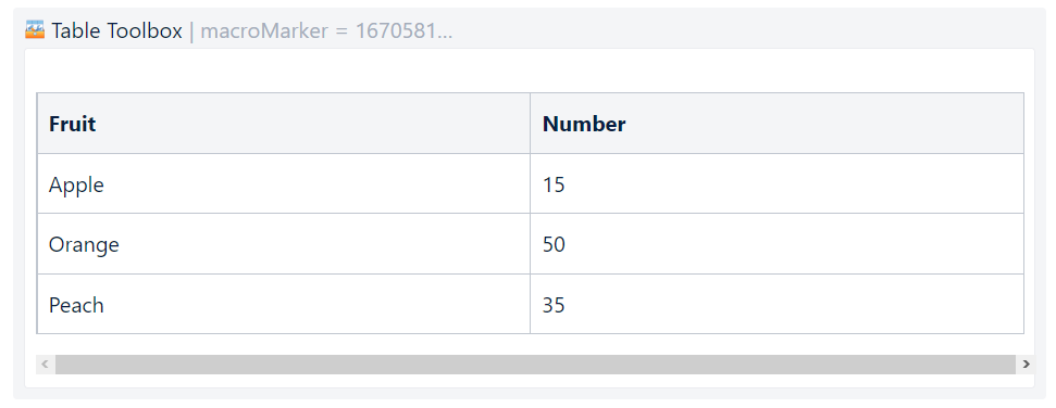

Wrap your table in the Table Toolbox macro

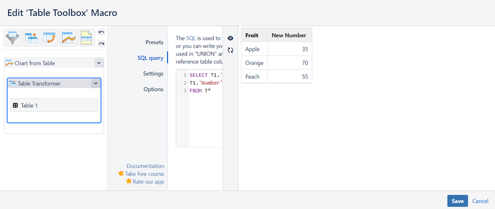

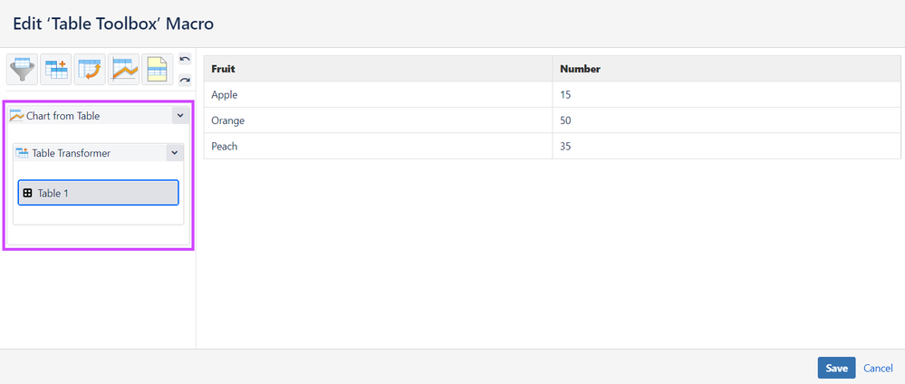

Go to the Table Toolbox macro settings and wrap your table subsequently in the Table Transformer macro and in the Chart from Table macro.
The Table Transformer macro helps you to apply SQL query to your table (transform it and perform different calculations).
For example, here I just add 20 to the “Number” column:
SELECT T1.'Fruit',
T1.'Number' + 20 AS 'New Number'
FROM T*

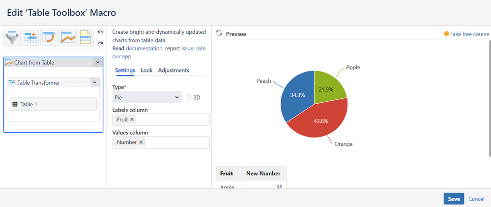

The Chart from Table macro allows you to build a chart based on the transformed table.
