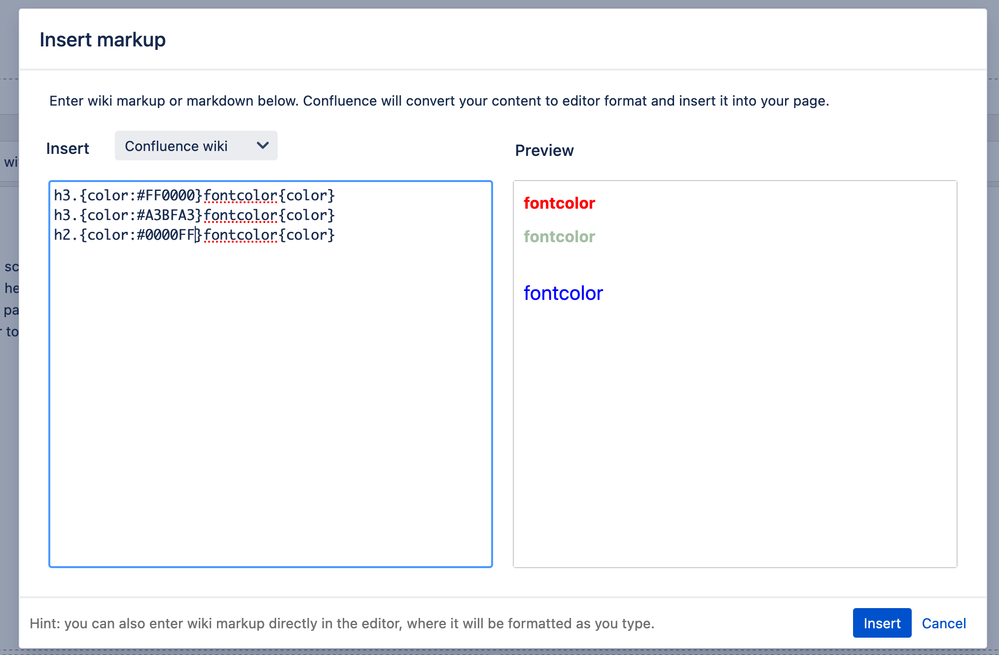

How do I nest wiki markup like h3. with a change of text color?
carly_noreen February 23, 2022
I have tried using basic html tags but it is not working?  It is just one sentence that I want larger and red for a banner

@carly_noreen , here is the screenshot with some examples

Hi @carly_noreen ,
Welcome to Atlassian community.
You will have to use the hex color codes . For example
h3.{color:#00875A}fontcolor{color}
which will translate to green color for "forntcolor".  Green color hex code is : #00875A
