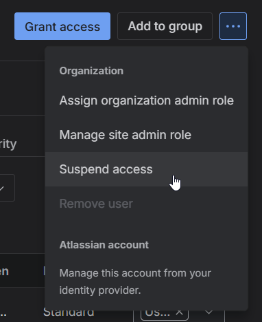

Hey @Dee from Texas ,
In this case, everything is managed on the Entra side, although it might depend on how the provisioning is set up/configured. As Dirk said, you can configure the scope of provisioned users/groups and sort them like that.
On the other hand, you can also navigate to admin.atlassian.com > Directory > Users and from there just suspend access to a particular user.
I'd still recommend resolving this on Entra side, but this is an alternative approach.
Note: Atlassian currently doesn't support merging two or more accounts > feature request: ID-240: Ability to merge Atlassian accounts to a single account with secondary emails
