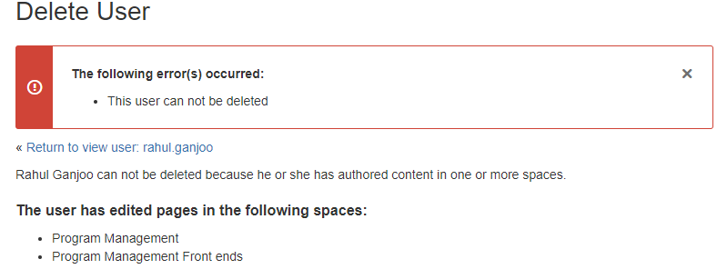

sachin kumar
July 22, 2022
getting below error when i am deleting user .
