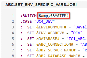

I discovered that the ampersand (&) is replaced with the corresponding HTML entity (&) whenever it is followed by a dollar sign ($).
Other ampersands are rendered correctly.

I found that the problem does not happen when the default syntax highlighting is enabled, but only when we use a custom one. I gather the problem lies therein. I’ll see if I can fix it.
