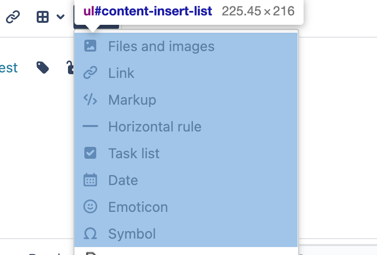

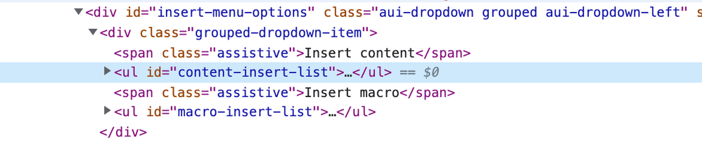

My macro is getting added in Insert menu toolbar but it is appearing below symbol macro as mentioned in attached snapshot. I tried to look into inspect option for insert menu toolbar , got to know that it is divided into two section like "content-insert-list" and "macro-insert-list". I want to add my macro at first position like above "Files and Image" macro . Could you please help to tell what value of section i need to pass to achieve this ?

Hi, the placement is controlled by the weight (what you show is weight -91). For my macros, I used weights 12 and 13 to place them middle of the pack. So experiment with a higher positive number.
BTW, weight is a classic UI parameter for menus.
Hi @Bill Bailey
Thanks for looking into it. I tried multiple combination of weight values even with 0 value but I'm not able to move my macro at first position. I want to list my macro at the place before "Files and images" macro is listed .
I also tried weight value as higher positive number but that is placing the macro to end of the pack. But I want to place at in the start of pack .
Thanks
Nishant
you tried a weight of 99?
Yes. I've tried it. But Unfortunately , Using weight value of 99 is going to put my macro at the second last position of the list.
