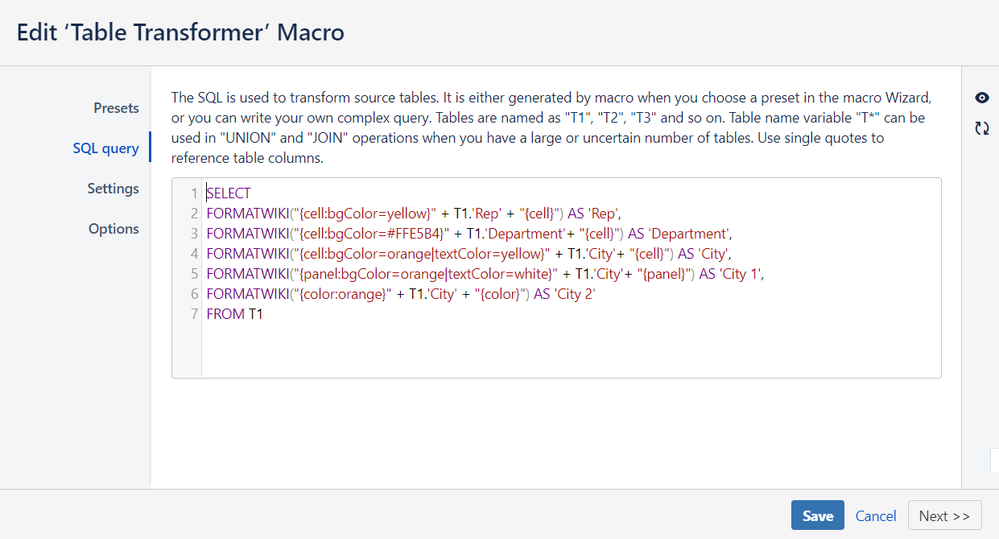

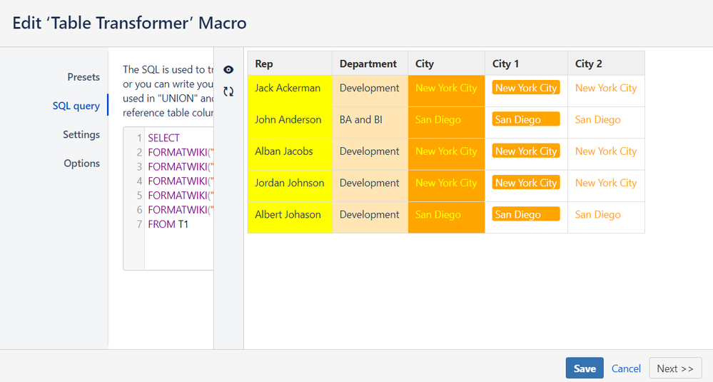

Hi @llatore ,
You may try the Table Filter and Charts for Confluence app and its Table Transformer macro with the wiki markup feature.
Wrap your table in the Table Transformer macro and use a custom SQL query to color your cells and/or text:
SELECT
FORMATWIKI("{cell:bgColor=yellow}" + T1.'Rep' + "{cell}") AS 'Rep',
FORMATWIKI("{cell:bgColor=#FFE5B4}" + T1.'Department'+ "{cell}") AS 'Department',
FORMATWIKI("{cell:bgColor=orange|textColor=yellow}" + T1.'City'+ "{cell}") AS 'City',
FORMATWIKI("{panel:bgColor=orange|textColor=white}" + T1.'City'+ "{panel}") AS 'City 1',
FORMATWIKI("{color:orange}" + T1.'City' + "{color}") AS 'City 2'
FROM T1

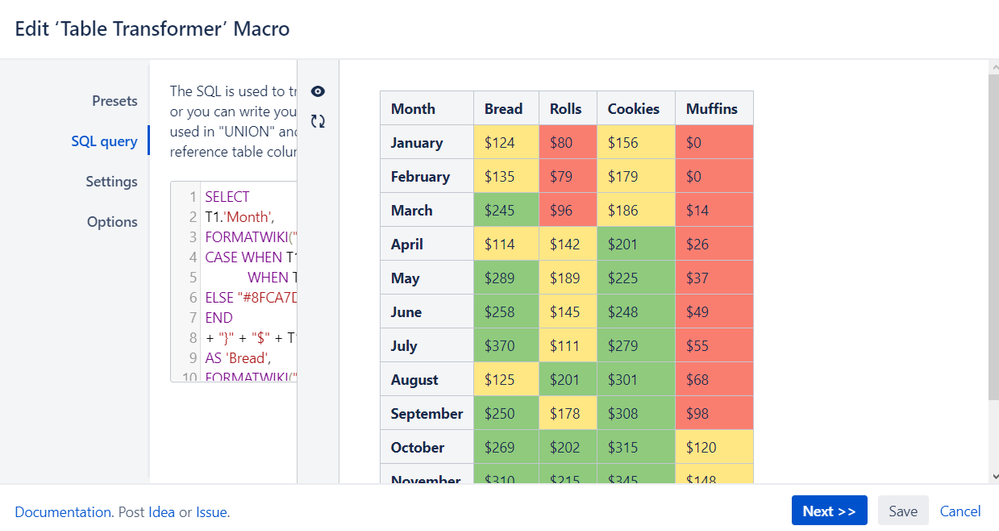

You can also use this macro for conditional formatting (like in Excel).
Here is an example of the possible SQL query and the obtained result:
SELECT
T1.'Month',
FORMATWIKI("{cell:bgColor=" +
CASE WHEN T1.'Bread' <= "100" THEN "#FA7E70"
WHEN T1.'Bread' > "100" AND T1.'Bread' <= "200" THEN "#FFE784"
ELSE "#8FCA7D"
END
+ "}" + "$" + T1.'Bread' + "{cell}")
AS 'Bread',
CASE WHEN T1.'Rolls' <= "100" THEN "#FA7E70"
WHEN T1.'Rolls' > "100" AND T1.'Rolls' <= "200" THEN "#FFE784"
ELSE "#8FCA7D"
END
+ "}" + "$" + T1.'Rolls' + "{cell}")
AS 'Rolls',
CASE WHEN T1.'Cookies' <= "100" THEN "#FA7E70"
WHEN T1.'Cookies' > "100" AND T1.'Cookies' <= "200" THEN "#FFE784"
ELSE "#8FCA7D"
END
+ "}" + "$" + T1.'Cookies' + "{cell}")
AS 'Cookies',
CASE WHEN T1.'Muffins' <= "100" THEN "#FA7E70"
WHEN T1.'Muffins' > "100" AND T1.'Muffins' <= "200" THEN "#FFE784"
ELSE "#8FCA7D"
END
+ "}" + "$" + T1.'Muffins' + "{cell}")
AS 'Muffins'
FROM T*
