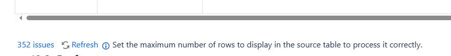

Is there an easy way not to display the issue count at the bottom of a jira query in confluence cloud? Would prefer just to display the table alone without the extras at the bottom.conf.jpg

Hi @Jason Dyke ,
As we see looking through your previous questions, you have our Table Filter, Charts & Spreadsheets for Confluence app installed for your instance.
If this is the case, you may wrap your Jira Issues macro in the Table Transformer macro, go the macro settings -> Options tab and choose the "Hide all content" option. The refresh button and issue counter will be hidden.

Hi @Jason Dyke ,
I don't think there's a way to remove/hide this. I've tried checking if there are any open suggestions related to your question/requirement, but couldn't find any.
I'd suggest reaching out to Atlassian Support and presenting this to them. They can probably create a new feature request if one already doesn't exist. If they do so, feel free to share the link here.
