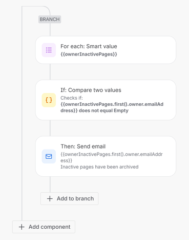

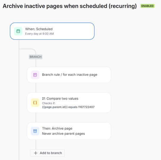

Problem 1:  The flow is wrong.
Here's how I would want the flow to work:
1. Identify inactive pages.
2. Apply exclusions or inclusions, if they're present.
3. Archive pages that fit the criteria.
4. Send the owner of those pages an email informing them of the archival.
Here's how the flow actually works:
2. Apply exclusions or inclusions.
4. Send the owner of the pages identified in step #1 an email informing them all pages have been archived, regardless of exclusions/inclusions and if those pages were actually archived or not.
How do I get that second branch to pull the "pages archived in step 3" value, rather than the value in step 1?
Problem 2: The "If" condition isn't working.
This one is set up very simply so I don't know how it's going wrong. It should be comparing the parent page of each inactive page to the specified ID and seeing if there's a match. I know it should be pulling up results, based on what I've configured. However, every time I run it, I get the "Unable to render smart values when executing this rule: Failed to get value for page.parent.id" error and it doesn't identify any pages at all.
I had this rule working correctly in my personal space, but when I duplicated it into a communal space, now it doesn't work, and I have no indication of what's causing the error.
I'm hoping someone can give me some insight here - I've reached the limits of what little documentation I can find. Thanks!

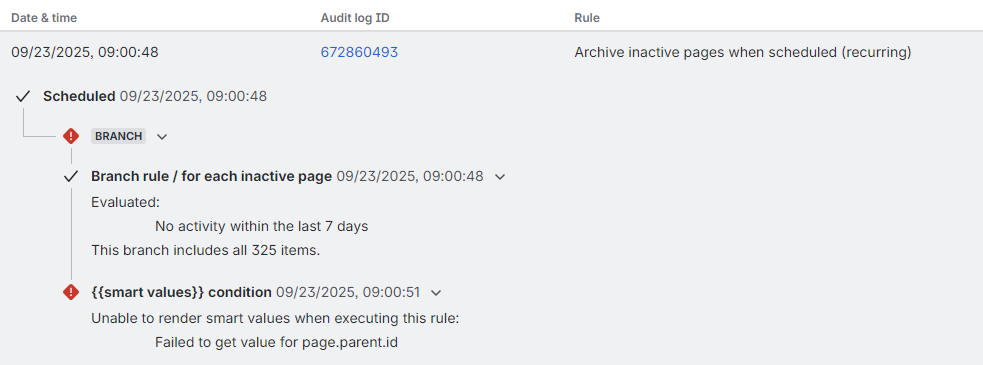

erica_bogosian
September 23, 2025
I updated it with the log action, and still got the same error: Screenshot 2025-09-23 090624.png
Bill Sheboy
September 23, 2025
Thanks for that information, @erica_bogosian
And...I forgot that unlike Jira rule smart values, Confluence ones are less forgiving when an object / attribute is missing.  To workaround this, a smart values condition with a conditional block is needed to first test if the parent exists.

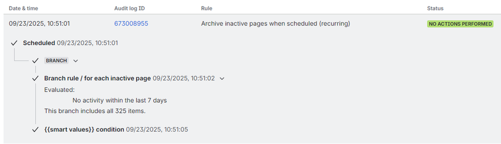

erica_bogosian
September 23, 2025
Well, it's not erroring anymore, but it's still turning up nothing even though I know there are inactive pages in that section. Screenshot 2025-09-23 105617.png
Bill Sheboy
September 23, 2025
That is curious; when I did a similar test filtering for a specific parent ID value, it found them and logged the values.
Have you tried adjusting the timeframe for the branch to confirm inactivity within that timeframe?  Please note this is what the documentation states that branch does, with italics added by me:
For each inactive page
A For each inactive page branch executes a condition or action on 1,000 pages that align with the criteria you select. An inactive page is any page that has not been viewed in the specified time period. The view history includes updates and comments made to the page.
erica_bogosian
September 23, 2025
Yes, the rule is set to pull anything with no activity in the last 7 days, and according to content manager, none of the pages in that section have had activity for at least two weeks.
