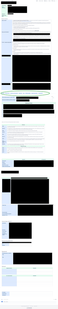

Hello,
I've created a Confluence page with tabs using the Localtab Group macro, but the information that I am putting into each Localtab macro box (i.e. each tab) appears BOTH in the tabs and all on the landing view when you arrive at the page (below the horizontal tab list).
How can I fix this so that when you open the page it only shows the landing view information with the list of tabs without showing all of the information located within the tabs (until you click on each tab)?
Thx!

@Eric Binning Did you create a tab group first and then add the localtab to that tab group?
https://bitvoodoo-apps.atlassian.net/wiki/spaces/BVNAVITABS/pages/5269062094/Localtab+Macro
Eric Binning October 6, 2021
@Brant Schroeder Hi Brant, thank you for the link! I found the problem on there. The issue was that I had all tabs marked as "active". Once I removed the flag for all of the tabs, I got the result I was looking for. Thank you so much for your help! Greatly appreciated :)
