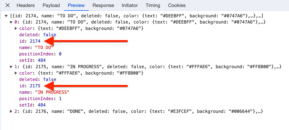

<ac:structured-macro ac:name="handy-status-macro"><ac:parameter ac:name="set">3</ac:parameter>
<ac:parameter ac:name="status">9</ac:parameter></ac:structured-macro>
Please note that 3 refers to the ID of the status set, and 9 is the status ID.
You need to replace 3 and 9 (ID of status set and status ID) with the ID-s you want to use. To do so, please take a look at the HTTP calls which is made by our app. We suggest doing it in the admin section where e.g. you can get this kind of result https://handy-macros.stiltsoft.net/rest/status?setId=484 where statys set ID is 484. Then, you can also learn the Status ID, which is available in the preview tab.
Have a lovely day!
