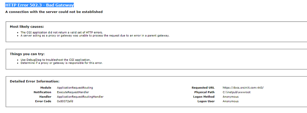

I have been getting the following error on my confluence server:
HTTP Error 502.3 - Bad Gateway
I have restarted server, restarted services, made sure IIS is running but no luck.

I understand that you're using Confluence server and seeing this error message.  However this error message comes from IIS.  Perhaps you're using this as a proxy for Confluence.  Unfortunately, it doesn't tell us enough to understand the cause of the problem, just that Confluence did not respond in time.
This could happen if Confluence is not started, or perhaps it crashed, or perhaps it's just too busy to respond to requests or that the configuration between Confluence and this proxy is misconfigured.
Is Confluence setup to run as a Windows Service?
If so, then I'd want to check the windows services to see what the current state of that service is.
If the problems persist after Confluence has been started, then I would want to take a closer look at the atlassian-confluence.log file from this startup attempt time.  If there is some error that prevented Confluence from starting, that log should have some more details there that could help us understand why it's not working.
