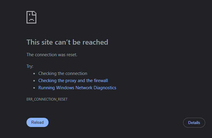

Since all i getting when trying to access the site is:
I highly doubt this is just an SSL Error...
