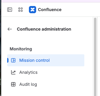

Requirement 2 and 3
You can get information about changes to Space permissions and Page restrictions from the Confluence Audit Log.
If you want to access the information with an API you can find information on that here:
https://developer.atlassian.com/cloud/confluence/rest/v1/api-group-audit/
