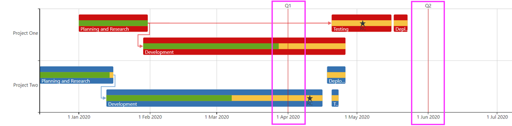

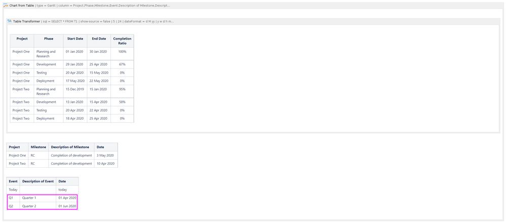

Hi @Arica Chan ,
We can suggest trying the following workaround: set quarters as custom events.
Hope this makes your chart more easy-to-read.
