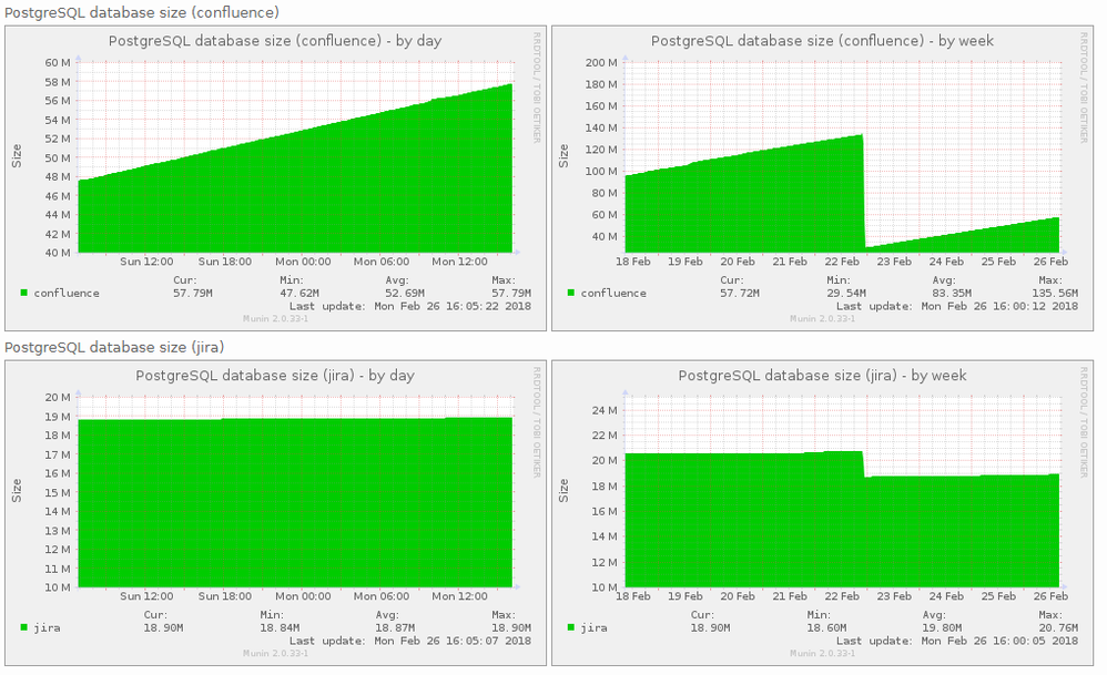

Confluence database size grows without much activity on this node. Please see the image attachedСнимок.PNGSteep drop on Feb 22 happened when I did FULL VACUUM on both databases and cleared confluence 'scheduler_run_details'  table. Nonetheless it is still growing. What's wrong here? Manually running sheduled tasks from Admin page in confluence does not clear the database.

I have already identified 'scheduler_run_details' as biggest, clearing of which gave the result you can see on the image attached.
To be more exact, at the moment 'scheduler_run_details' occupies nearly 13 MB, 'EVENTS' -- 2.6 MB. So, for  'scheduler_run_details' it is plus 13 MB since Feb 22.
The next table by size is 'AO_6384AB_FEATURE_METADATA_AO', which occupies 0.6 MB approx.
While I was writing this reply, the only table that grew is 'scheduler_run_details'. It grew from 13484032 bytes to 13516800 bytes.
