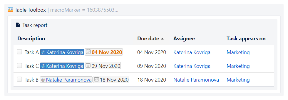

We can suggest a workaround with the help of the Table Filter and Charts for Confluence app.
Wrap your Task Report in the Table Toolbox macro and create the following nesting: Task Report <- Table Transformer <- Table Filter macro.

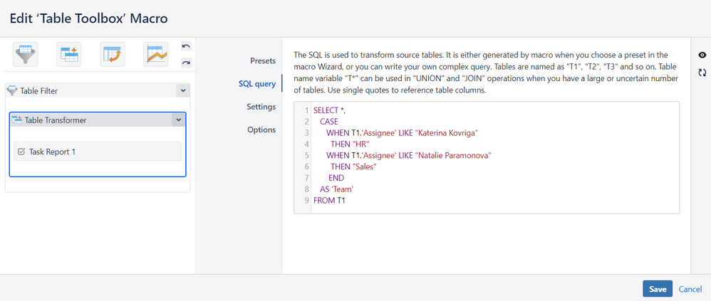

Wed 1-1.pngGo to the Table Transformer macro and create a custom SQL query:
Wed 1-2.pngSELECT *,
CASE
WHEN T1.'Assignee' LIKE "Katerina Kovriga"
THEN "HR"
WHEN T1.'Assignee' LIKE "Natalie Paramonova"
THEN "Sales"
END
AS 'Team'
FROM T1
As you can see from this example, we put our assignees to the corresponding teams. Now we can filter our tasks not only by assignees, but by their teams as well.

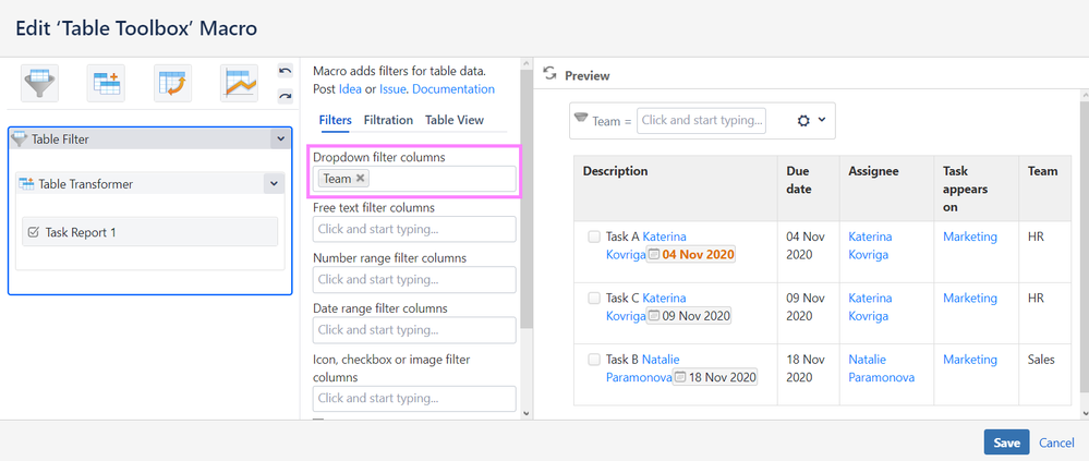

Just go to the Table Filter macro and set the dropdown filter for the required Team column.

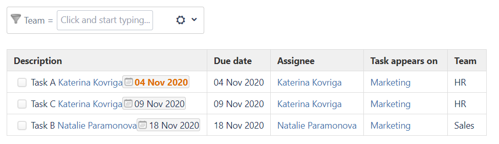

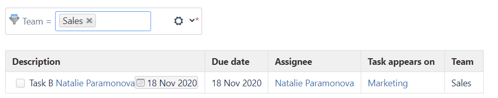

Here is your result table in the view page mode:
Wed 1-5.pngWed 1-6.pngNote that our example is a simple one just to show the case. You can modify this SQL query and have as many teams and teammates as you need in real life.
