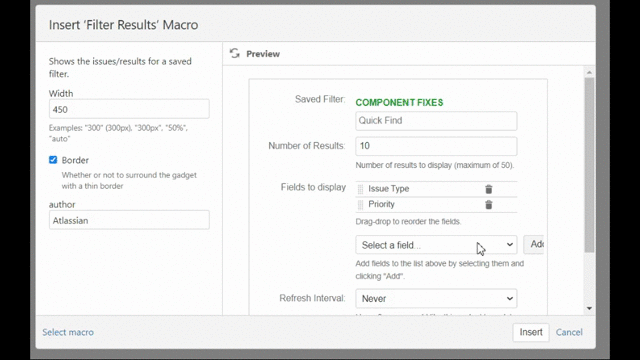

Are you facing the same issue as the bug below or is it a different behavior?

  • Correct Behavior
    • When you add a base field to the widget and select the internal save button on the widget settings, a loading bar appears and then the widget reappears, allowing you to select the external save button on the widget control.
  • Incorrect behavior (What I'm seeing and what your video appears to show)
    • When you add a custom field to the widget and select the internal save button on the widget settings, there is no change, sometimes a console or network error will appear but it is inconsisten. The only consistent behavior is that the loading bar doesn't appear and when you to select the external save button on the widget control, no changes are populated to the widget.

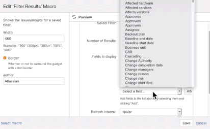

Can you please let the developer tools opened on your browser and then follow the steps again to check if some error will appear after you click on Save? Please, share a screenshot of the errors or warnings with us. Just make sure to hide private information.
