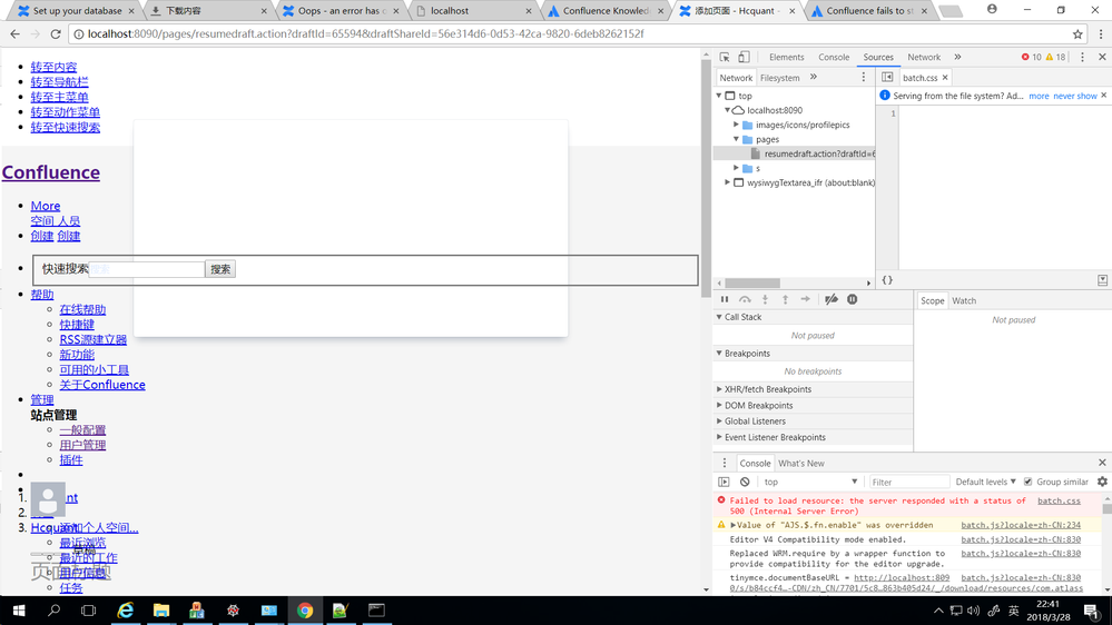

Wangxc
March 28, 2018
aaa.pngAs you can see. the batch.css is blocked by server ,How should I do for it ? THX!
