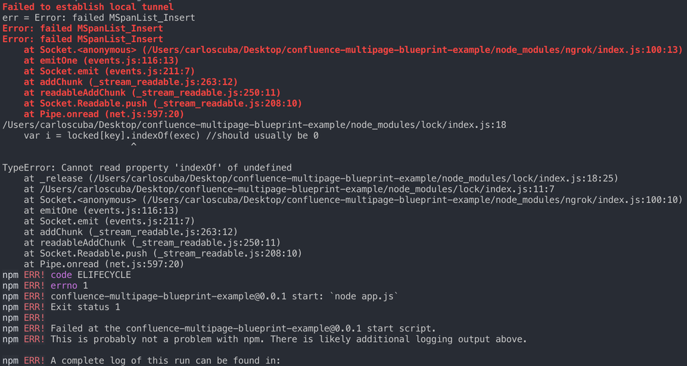

However, when I run npm start I get this error:

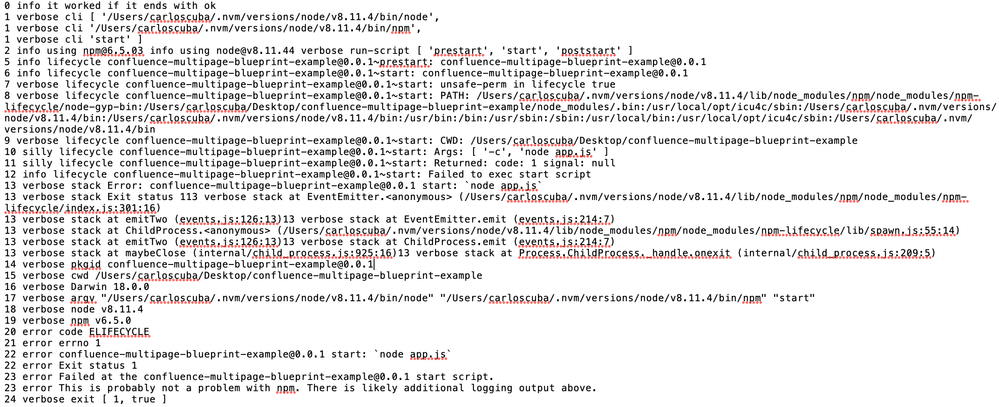

And the debug.log file looks like this:
From the error messages thrown, I gather that the main error is that a local tunnel cannot be established (Failed to establish local tunnel) because of failed MSpanList_Insert.
Looking this up online I thought it would have to do with having an old version of Go/GoLang, but my go version command outputs go version go1.11.5 darwin/amd64 (I'm doing this on a MacOS Mojave 10.14)
Also, the line Cannot read property 'indexOf' of undefined seems to point to to an error with the lock package. I also tried looking this up, but found little help.
